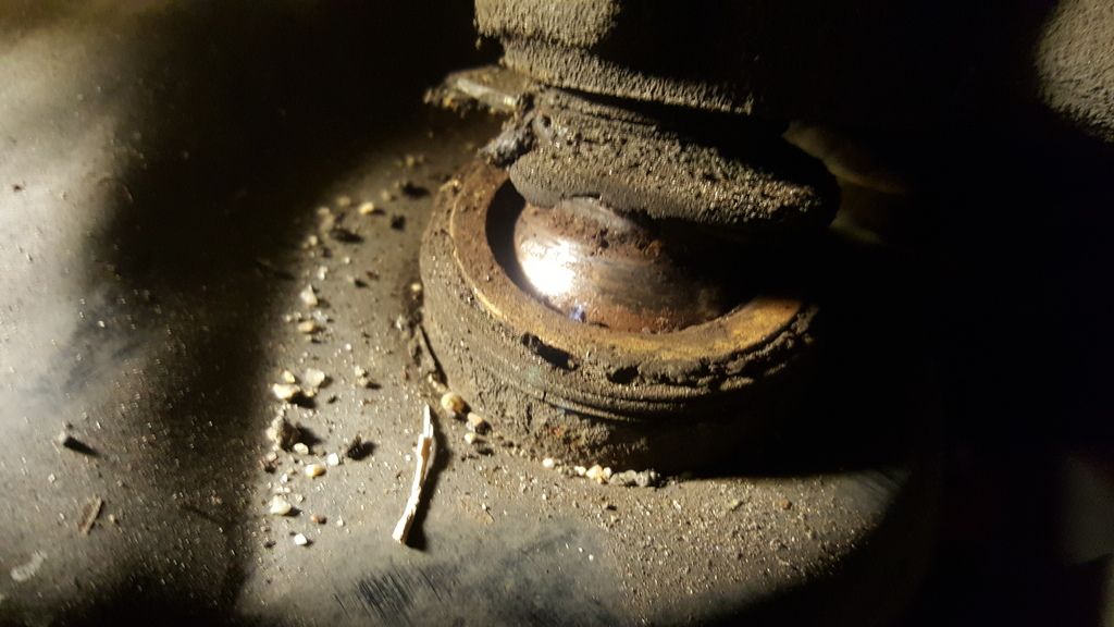

    Driver ball joint still in the car:
    [​IMG]

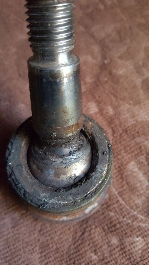

    Drivers removed:
    [​IMG]

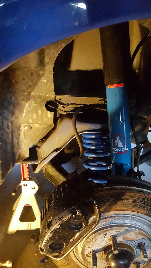

    All put back together. Too cold to paint anything so that part has to wait til better weather.
    [​IMG]

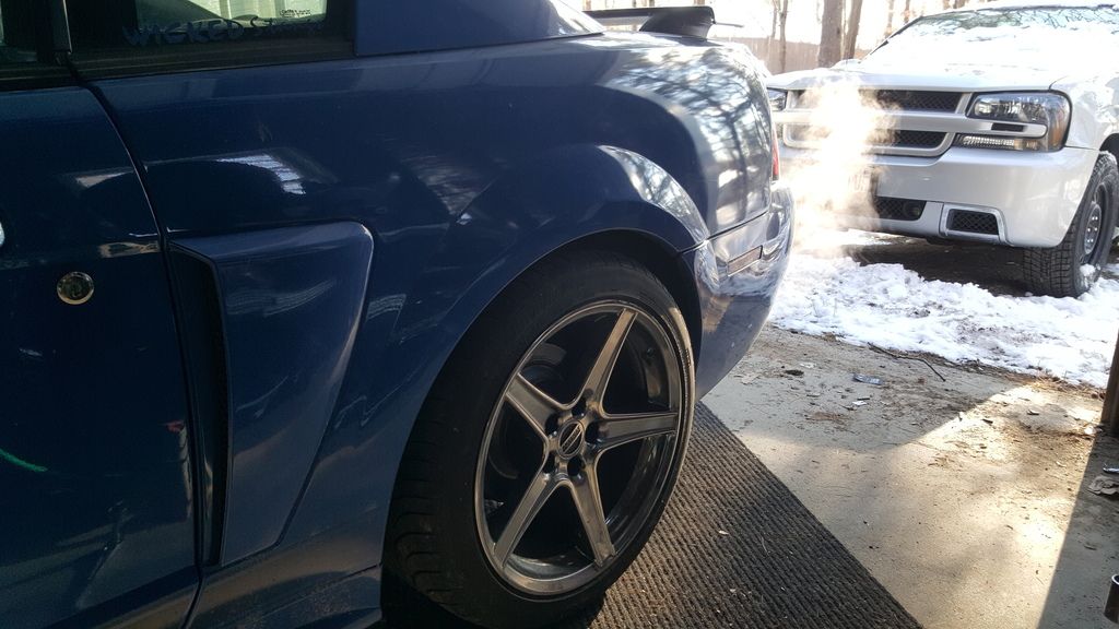

    Rear after lowering:
    [​IMG]

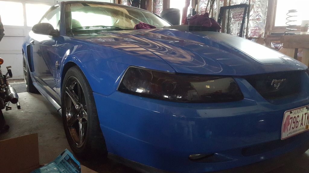

    Front angle after lowering:
    [​IMG]

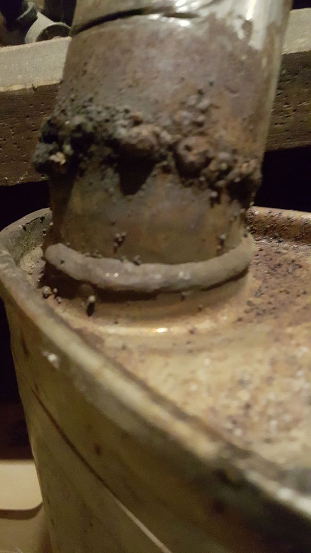

    The magnificent welds that were done to piece together a inspect able exhaust when they sold the car to me at Honolulu Ford.... cut it out and am putting the MAC system in this weekend.
    [​IMG]

    That ball joint will jar your teeth out of your mouth. Nice pics and Tokico shocks/struts are an excellent choice.
    Did Emilio weld that muffler???? LOL!!!

    I think E definitely did that welding when he was sober, drunk he would do better....
