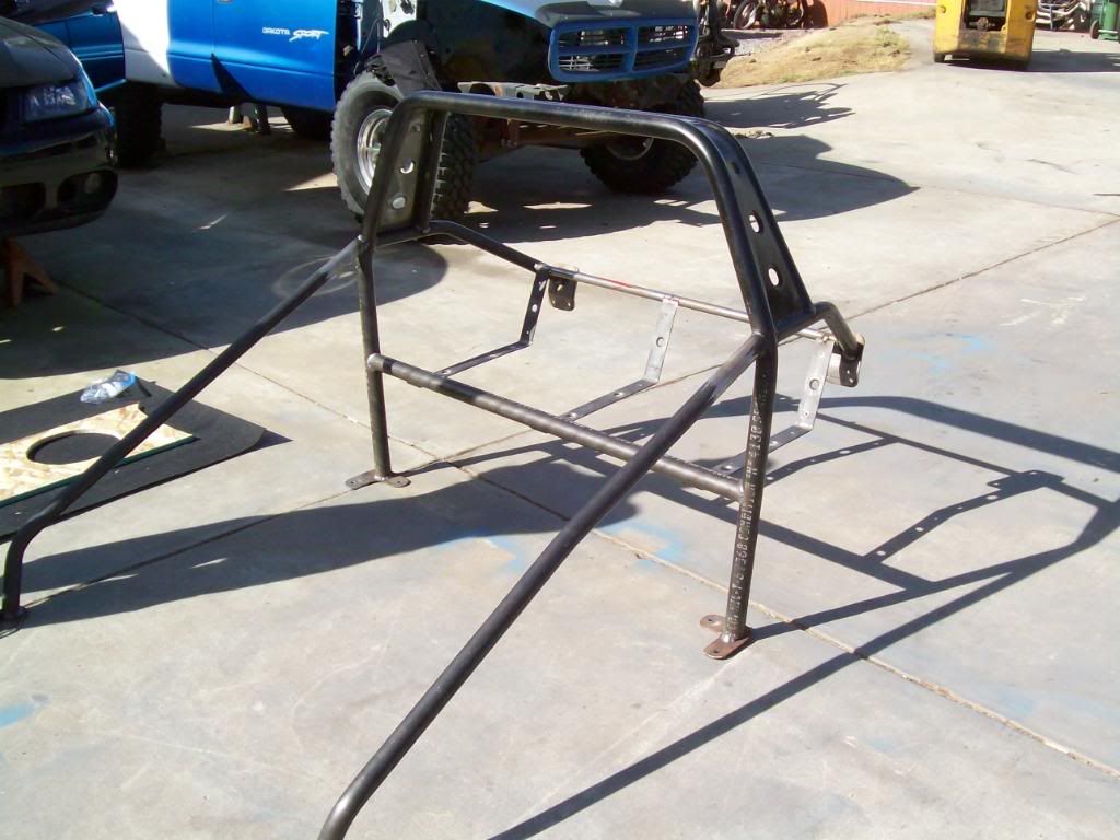

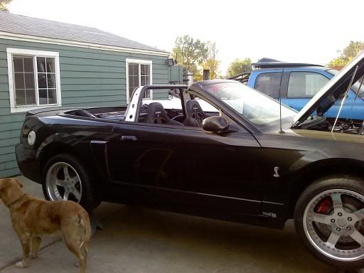

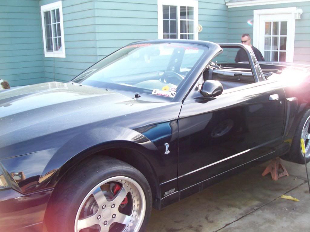

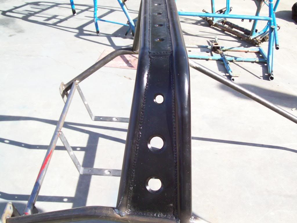

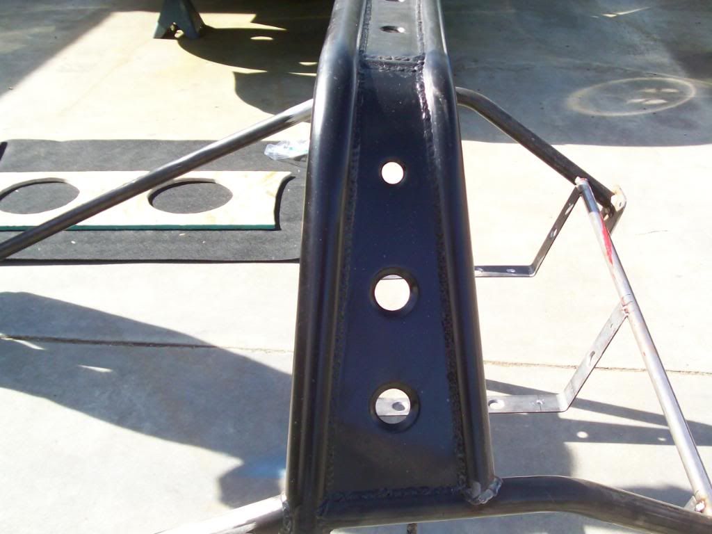

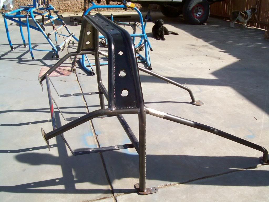

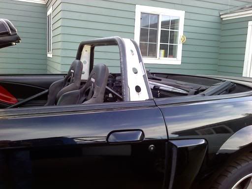

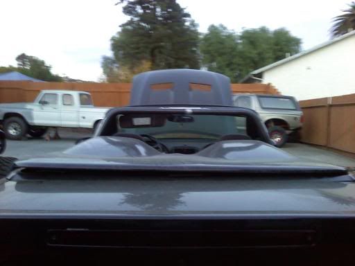

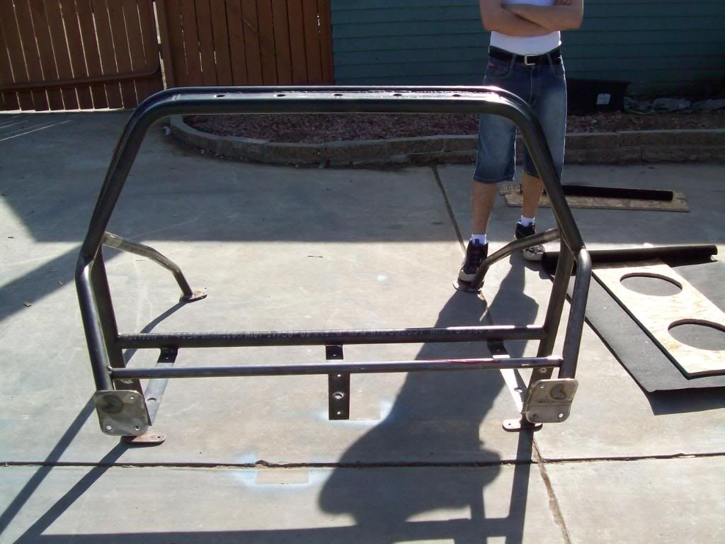

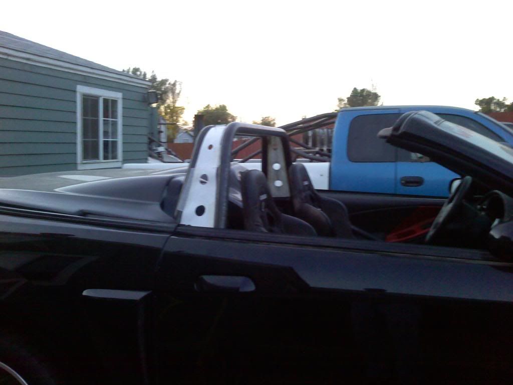

Here is a lil update on my roll bar install
orange395w
OG MEMBER

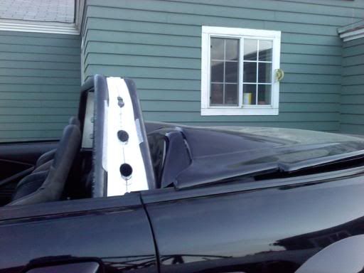

Looks great! One thing that cought my eye was the way your seat belts were mounted to the roll bar. That is a no go at Irwindale and maybe Fontana. Barona won't give a rats ass, but just a heads up in case you plan on going up north to race. The belts have to be bolted to the roll bar so they can't move side to side.
Awesome job on everything!!
