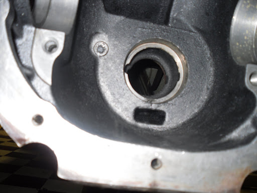

About to finish my rearend!
Heres a few pics.

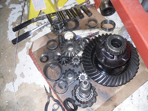

old parts not reusable.
got it clean ready for install

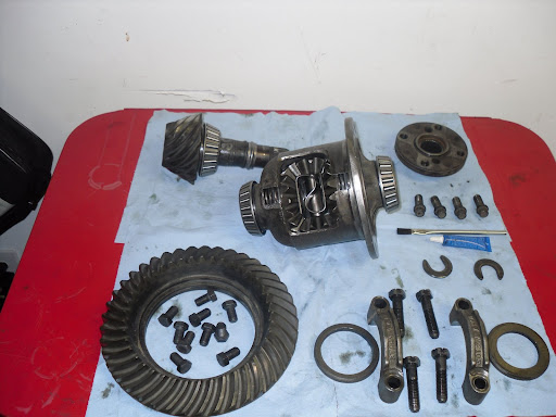

all new parts clean and ready to go back in.

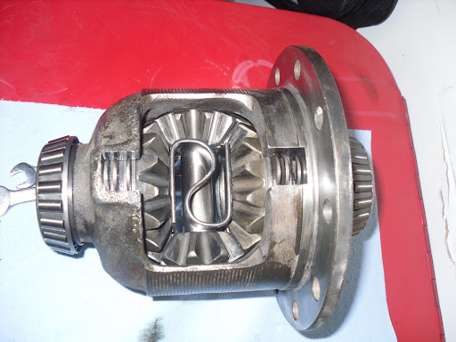

Diff with new clutch packs and new bearings. Got everything with VERY low miles!
fully disassembled it just to check everything out.

new bearings (Complete rebuild kit)
new 373 ring and pinion.

Got everything together. It has a nice pattern on the gears.

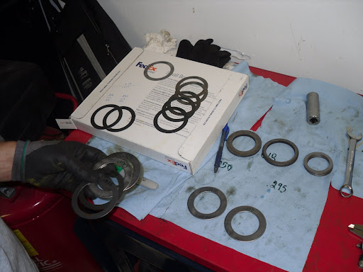

Didnt know so much math was invovled in doing a rearend, LMAO. Got the shims all measured our right though.
