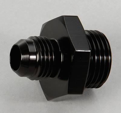

Well I went into the garage and searched for some spare fuel stuff and this is what I came up with................
I have enough -8 fittings for everything. I have enough-8 line to do one rail, and enough -6 for the return to regulator.
My suggestion to save a little money: Eliminate the y-fitting and run a -8 female on both ends. Then loop the fuel rails together in front and route the return to the regulator. If we ran it like that all we would need are the fuel line fittings. It would look something like this :)

Hold off on the fuel rails. I'm taking the rails off of the one attached to the 2000 GT we are pulling apart. Maybe they will fit?
Orange, nice find on the fuel lines. I'm running that exact fuel setup on my car. It works well. We can save the Y-fitting for later when the horsepower demands a better feed.
