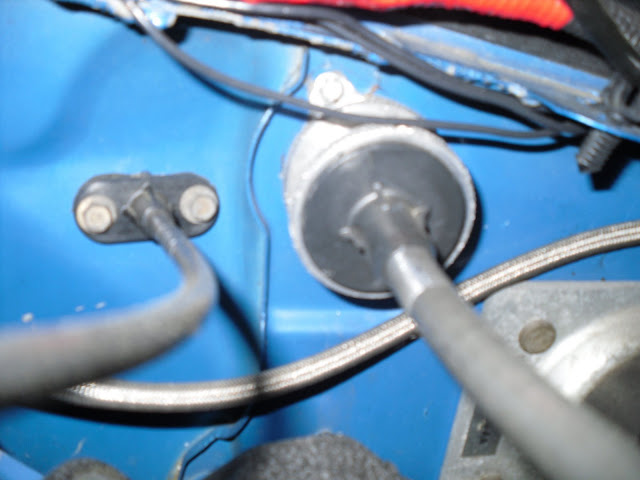

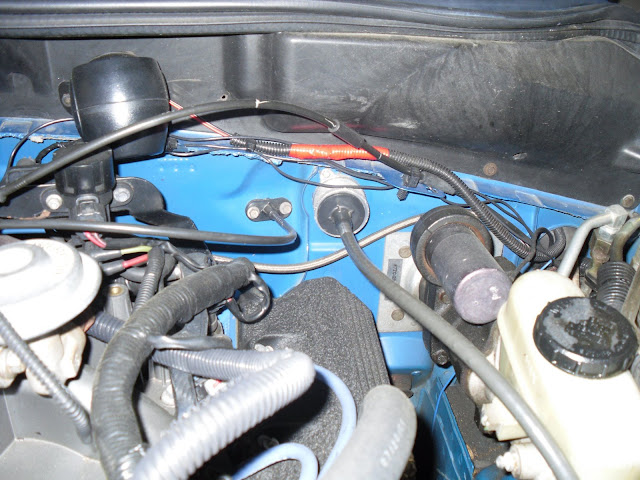

so it dosent come stock with a firewall ajuster? i think the guy before me accualy put one in, where is it on the car? this is my first stang, sorry if i sound a little dumb on this stuff
just took this pic of mine.
its the one on the right.
thats a wider shot showing how close it is to the brake master. You can follow the cable from there to the firewall.
Hopefully it is just the cable. If you have an aftermarket cable you might be able to adjust it under the car where it goes through the shifting fork.

i just checked the firewall it was a little loose so i tightened it and all seems well now, thanks alot guys, i was prayin i wouldent have to get trans work done
the best way to set it... is tighten it.. then see if you can put on the cable to were you can fit a quarter in between the cable and firewall adjuster.... that's what steeda says... i don't like that pedal feel of that, i like mine really tight... If you mess with it enough you will find a good spot for yourself and the car wont grind and the clutch wont slip...
I havnt never heard the quarter trick. Have to try that next time. It a t45 in the 96-01 just diff speedo in 99+ they changed to t3650 in 02.
