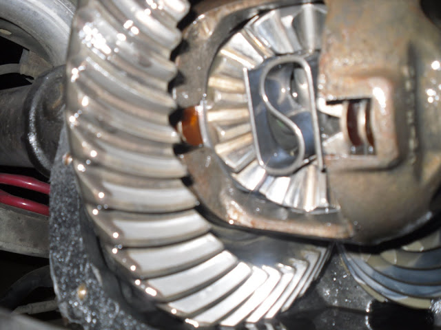

it was only a broke axle. the spider gears and diff is just fine. The axles are two years old. Wonder whats the warrenty for them. I might just get better axles. Ill use my stock axles for now. I can have it driving again tomorrow for only $58. Gasket, 2 qts of royal purple gear oil, limmited slip additive, and hi temp sealant. I'll load pics after I eat.
everythings still in tact. Made about 5 rotations. I didnt see any chips or cracks.
yep, that is same exact set up as mine except for the differential, although, c clip eliminators have a tendency to leak a little bit, mine are the street clip elminators, mine didn't seal real well on the drivers side so when i take long trips to fontana it tends to leak a bit. as far as your qestion about the axles and eliminators they will fit bobby and i were concerned about it too but he was able to get them to press on just fine.
