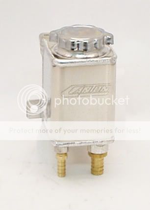

this looks like anice unit.
thats a Air compressor water trap!!! lol... it will do the job though... now back to this rich mixture code... so the guy that did your tune pretty much just changed your timing... i believe a 12.0:1/12.8:1 a/f is a stock wot A/F.... correct me if im wrong?... 14:1 is a cruise or none WOT a/f stock...

If the engine is running rich the plugs will likely be black. Why the hell did you order that thing when I told you 2 times in this post you could get it for $12.99!!!! Steeda sells it for $70 plus shipping!!!!
An Old timer once told me that "if you want to own a race car you have to learn how to work on a race car". You could have saved yourself $50!!

Thats what i thought they should look like. Yeah 91 was in the car. I plugged in my diablo in again today and i dont have any trouble codes. I dont know what that is about but we'll see. the oil collector was a impulse buy i have a mental moments from time to time. Oh well.
