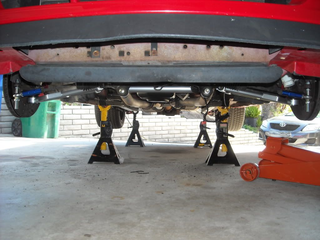

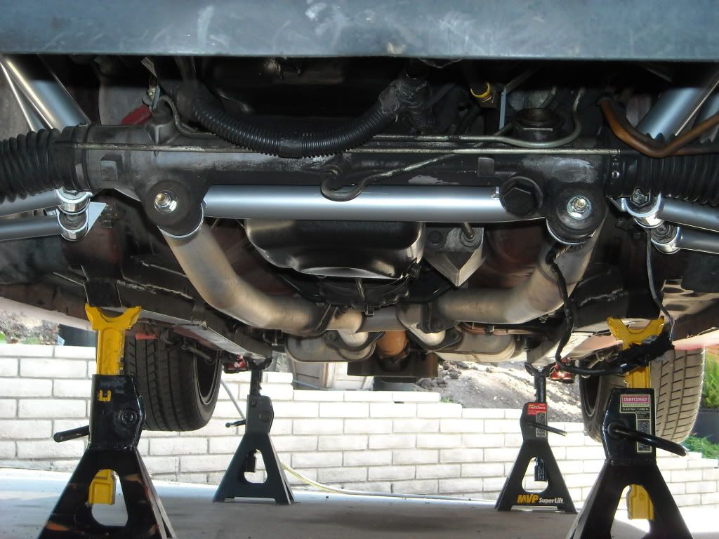

Today I finished Eric's car. I went to NAPA this morning and bought the bolts for his steering rack. The kit didn't have them and the stockers were too long.
Then I installed the bump steer kit.

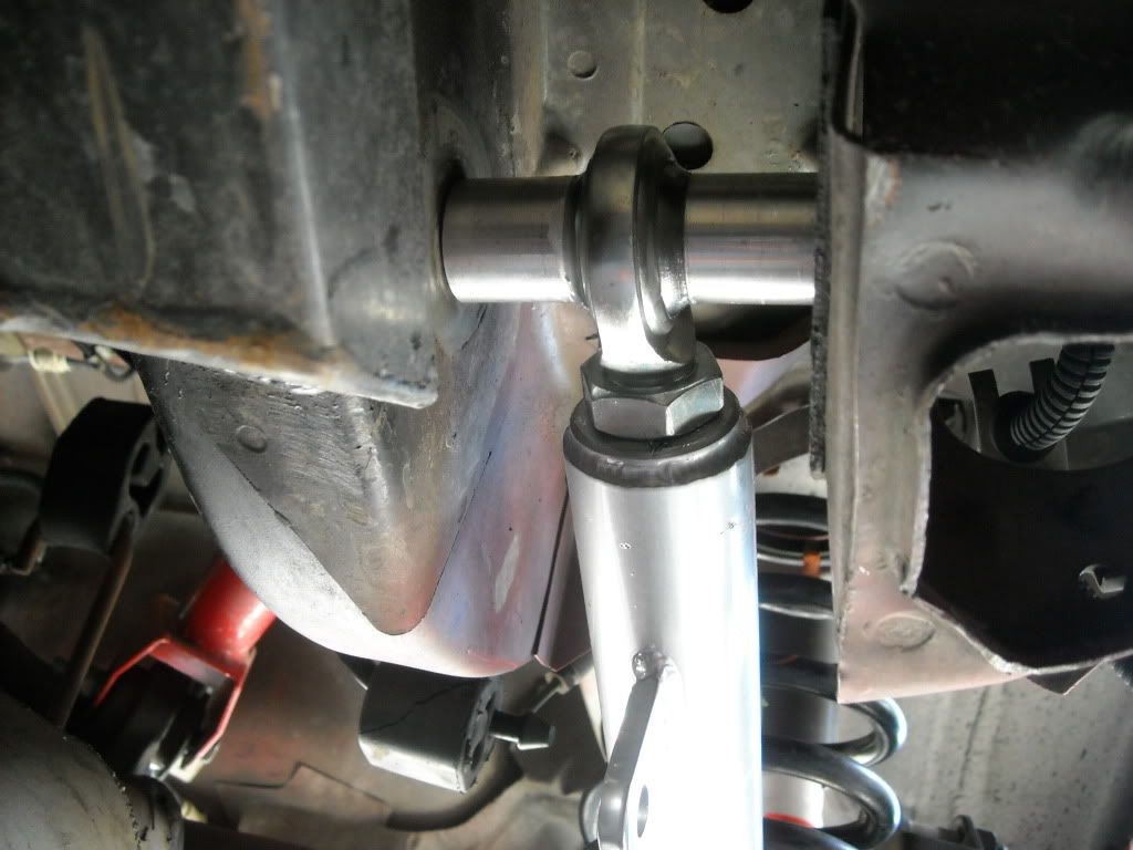

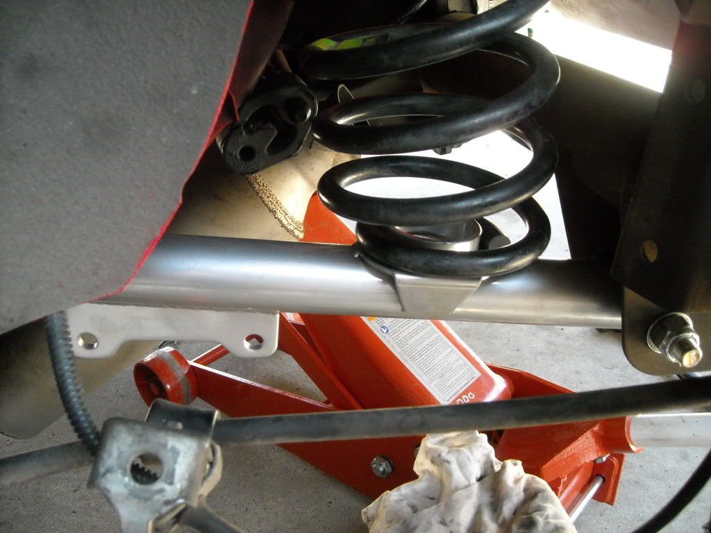

After that I put the front wheels back on and noticed that the front wheels were rubbing the coil overs. I had to max out the negative camber to get the coil over as far away from the struts as I could, but you would be lucky to fit a few sheets of paper in between. May need some wheel spacers.

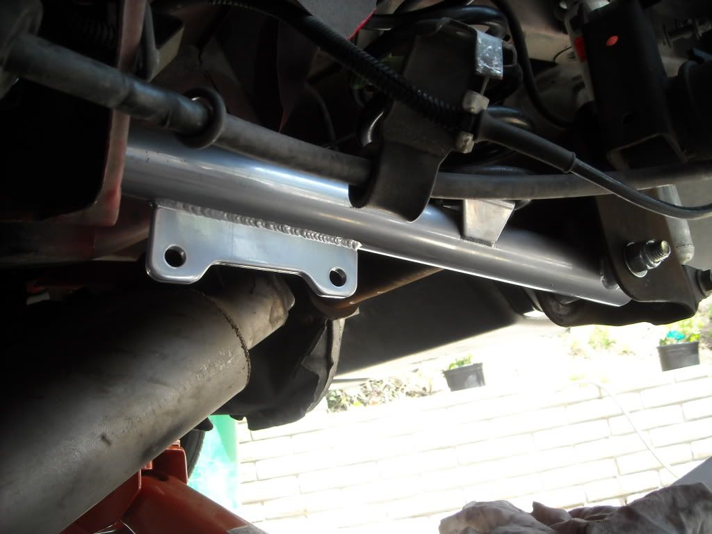

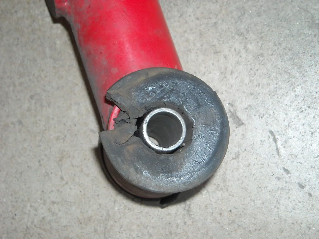

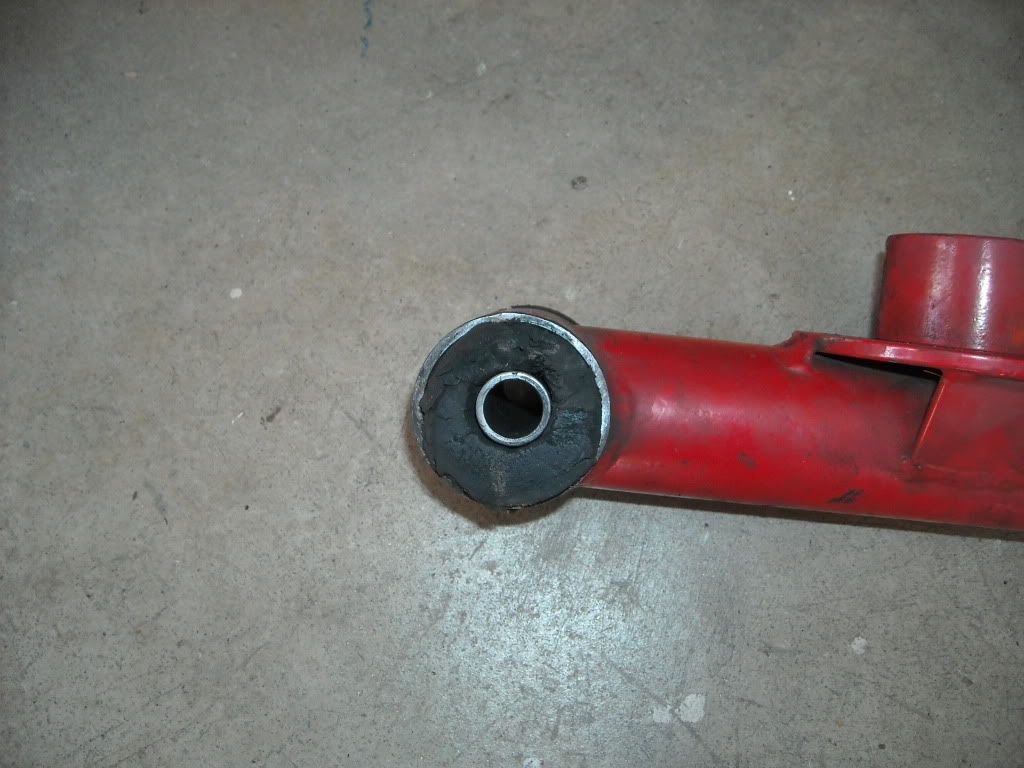

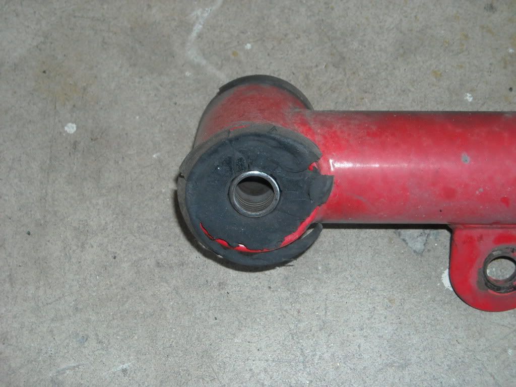

I also Swapped out Eric's Rear lower control arms with some UPR solid adjustables. I started a thread about drag racing and rubber bushings a while ago, but didn't have the pics. Well Here they are!!!!!!!!!!
Right Rear Control Arm.
Left Rear Control Arm

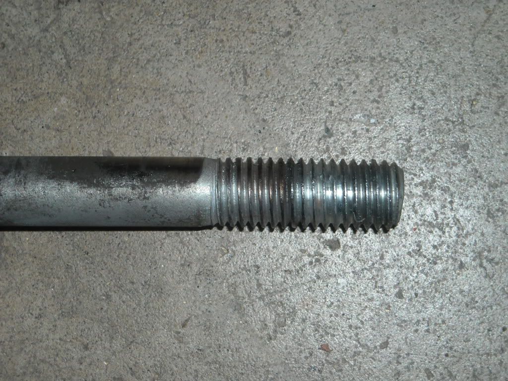

There was so much movement going on because of these wasted bushings that these bolts were actually bent!!! Hard to tell in the pic, but trust me it was BENT!

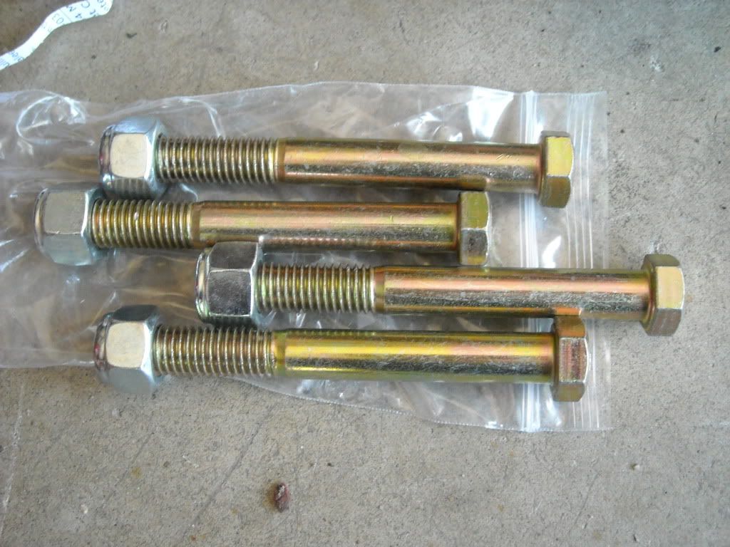

Another trip to NAPA for some grade 8 hardware
Out with the old in with the new! These relieved a ton of stress on the torque boxes with the spherical bushings. The old ones had to be pryed into position. These were a piece of cake. :)
These new control arms were 3lbs vs the other ones which were 6lbs.

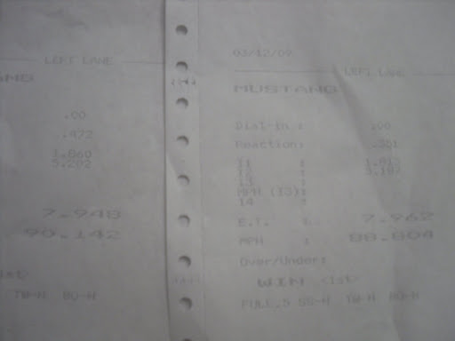

i wounder what the rear sway bar weighed...i think it might be about 18-20 lbs....if i dont break down 7s ill just drive off the cliff with you seeing how you didnt break 6s....

im gonna need to pull another 1.6 60' to get the car to get close to the 7s but debating whether i should strip the car down or just leave the weight in the back...
