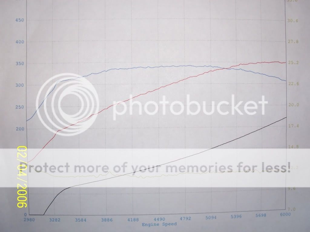

well i got the car tonight, Dante tuned me up on his mustang dyno and the base was at 352 RWHP and 342 RWTQ with 9 LBS of boost, timing was at 14* and the avg A/F was 11.9(RET TUNE),
this is the original tune, dante gave me a less agressive tune, the 321 rwhp and 329 rwtq is with 8 lbs of boost and water/meth injection. The air/fuel is set to 11.5 and 12 degrees of timing.
this is my base line tune. note: 11.9 to 1 A/F ratio 14 degrees of timing. this is RET's tune.
