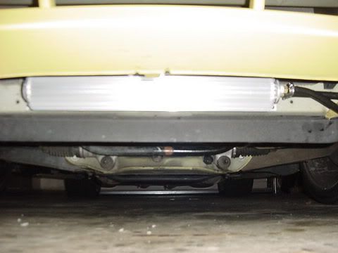

One day the stick will come out of the Cobra! Auto is better at the track period. High HP cars dont run standards for a reason. People that go to the track alot are digging for that next 10th of a sec so yes a huge improvement. Seen people buy new Terminators and take them straight to the shop for auto and a solid rear end. Here is the cooler I installed on my supercharged GT.-Shane
Driveability is subjective, but personally I like the firmness of the shifts. With the race kit and the valvebody, you'd be well on the way to a durable tranny. Two other mods that are needed a good built converter and tailshaft oiling modification.
You've prolly seen me recommend the B&M Hammer for a shifter. I also used a F250 Superduty tranny cooler in my old C-4 combo and I'll be using it on my new one also.
