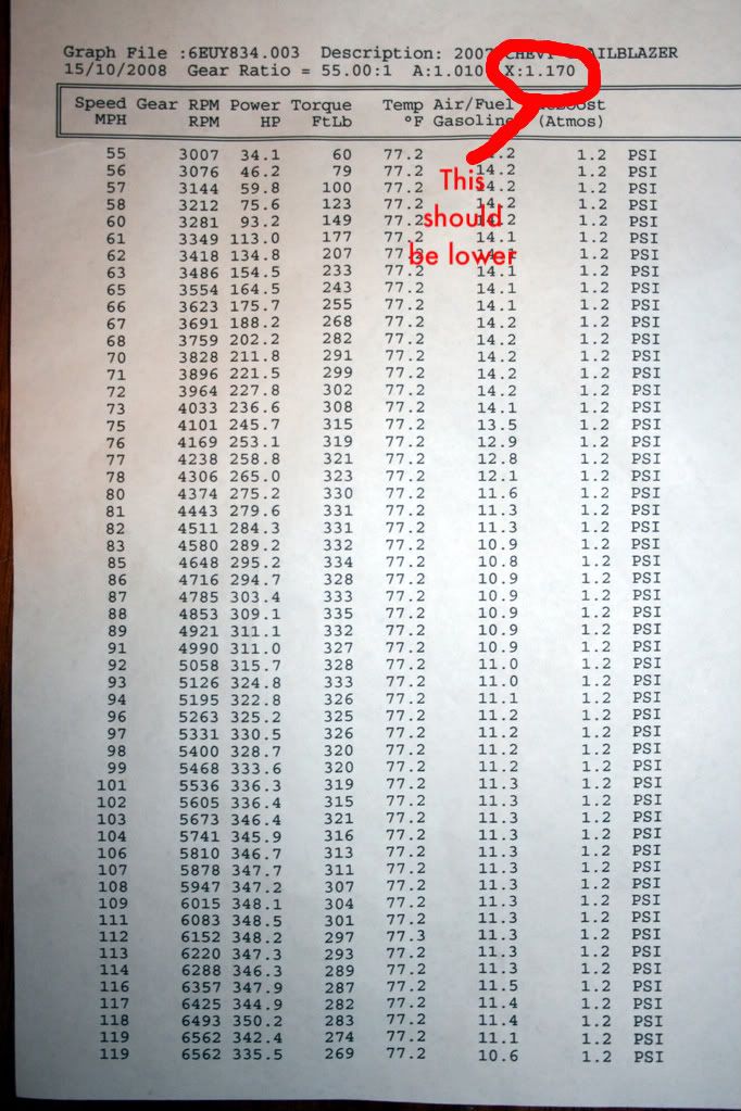

Look at the correction value........from what I was told. a 1.17 is way high.......
Should have been lower. That would inflate your numbers.
Here is what I am talking about.
If I am wrong I am sorry, just going with what I was told.....

Gib you're right. Although I cannot recall on a dyno dynamics whether they can manually enter the correction factor or not? Some dynos you can and some use weather stations that automatically figure the correction factor for you, (but most of the time can be over-ridden anyhow). Way back in November 2007 when we used their dyno, it had that same 1.17 correction factor, so theoretically if you use that correction factor and it is valid, which it should be, the DMP truck laid down 826/798.
Divide your numbers by whatever correction factor is on your print out, and that should give you pretty accurate corrected results.
For instance, DSGs numbers are more realistic and seem appropriate at 393/379 for his mods. FFS
So in this case, I would take 348/335 and divide by 1.17?
Doesnt the computer already do that once?
297/286
Seems low by that theory for a 395 HP setup.........

That can't be right.
That formula says that we all have in actuality, only 85% of what they recorded.
That's not possible. Nobody is THAT far off!

But I keep coming back to the same dilemma....My car dynoed right where it should have!
What's up with that?
Last time I dynoed was 325HP. I added an X-pipe, Borla Stingers and lighter wheels (rotating mass). I expected about a 10-15 HP gain from all three.
And I dynoed at 340, right on the money!

I'm convinced it was this scenario....
"Get the money, get them in, get them out, tell them what they want to hear...NEXT!!!!!"
The not being strapped down would cause you tpbe lower than expected and their Dyno.....aka "Dream Maker" is reading high......
My ratio was 55:1 and the correction factor was 1.17.........I have a stock TBSS with 4.10 gears. How the heck can you tell if that is the right ratio? I work with reduction gear and crap. I know how it works, and what the ratio means but how would I know if that was correct or not?
